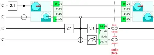

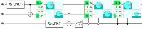

Here's a simple circuit construction. Not sure if it's optimal.
By using a CNOT gate onto a partially-rotated ancilla qubit, you get partial information about $|00\rangle$ vs $|11\rangle$. You can tune the rotation so that one of the measurement results gives a post-measurement state that's exactly $|00\rangle + |11\rangle$. The other measurement result is some other $\alpha_2 |00\rangle + \beta_2 |11\rangle$, with a worse balance than before, that you can repeat the technique on.
One round:
Three rounds
There's probably some simple way to get it done in a single round instead of in multiple rounds like this. It seems like using a second masking ancilla might do the trick, but I didn't see the easy way to compute the angles. You can see in the screenshot I'm close but not bang on (50.2:49.8 instead of 50:50).
