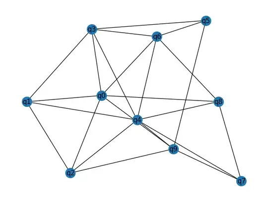

Once you have the circuit, it's quite easy to get the graph into a more normal format such as networkx:
import networkx as nx
graph = nx.Graph()
for instruction in graph_state_circuit:
    if instruction.name == 'CZ':
        targets = instruction.targets_copy()
        for a, b in zip(targets[::2], targets[1::2]):
            graph.add_edge(a.value, b.value)
nx.draw(graph, labels={k: f'q{k}' for k in graph.nodes})
# draws (for example):
