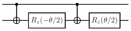

A good starting point is the following circuit: enter image description here If you work though it's action, you'll find that this is (almost) the controlled-phase that you want. (I think you also need a phase gate on the top qubit). So, then it's just a case of decomposing the phase rotations in terms of $H$ and $T$ to your desired accuracy (you'll want them each accurate to $\epsilon/2$ in order to ensure overall $\epsilon$ accuracy). This answer links to a paper and code that can do this for you. It's not something you want to do by hand!
However, before you make this too complicated, check the requirements of your project: if you are measuring the qubits immediately after the inverse Fourier transform, then you don't need the controlled-phase gate at all! You can perform the measurement of the control qubit first, and then, depending on the output, apply just the phase gate on the target. This reduces the complexity a bit because, for example, if you had to implement controlled-$T$ before (not in your gate set), then now you just have to implement $T$ (in your gate set)!
