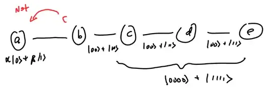

With a supply of pre-entangled pairs between multiple locations, the state may be shared using daisy-chaining and just a single measurement at the signal origin:
$$\alpha(|00000\rangle + |11111\rangle) + \beta(|10000\rangle + 01111\rangle)$$
Measurement at $A$ collapses the entire daisy chain into:
Case $q_A = 0$
$$\alpha|0000\rangle + \beta|1111\rangle$$
Case $q_A = 1$
$$\alpha|1111\rangle + \beta|0000\rangle$$
Broadcasting the measurement result at $A$ now allows any other station $B,C,D,E$ to deduce $\alpha, \beta$ appropriately.
