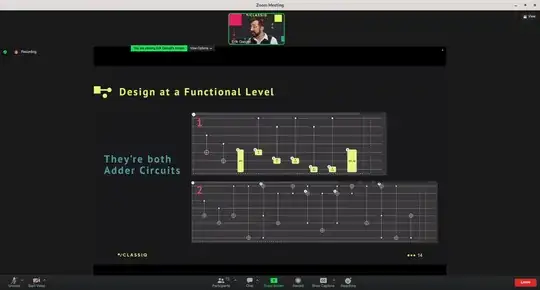

How to see that both are adder circuits in terms of conventional classical circuit logic ?
Strange, the first circuit uses QFT , while the second circuit is using ripple-carry architecture

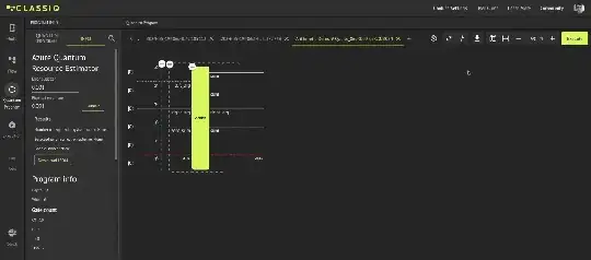

When choosing depth optimization, you will get a CCX implementation. This is because it uses auxilarries to optimize the depth, and does not using QFT. Also it is more suitable to basis gates hardware that are using CP as a basis gate. The actual implementation is very simillar to classical one - add to qubits, and take the carry to the next one: enter image description here

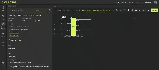

QFT on the other hand, is converting the addition to the phase space using QFT, adding phases with controlled-phase gate, according to the original qubit, and convert back to the computational basis using inverse QFT. enter image description here
