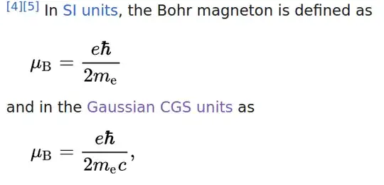

The CGS units have an extra $c$ in the denominator when compared to SI units, for example:
