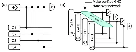

Nickerson et al. implement surface code stabilizer measurements by using a purified GHZ state as a resource state. In the image below, schematic (a) shows the usual surface code stabilizer measurement circuit and schematic (b) shows the GHZ state-based approach.

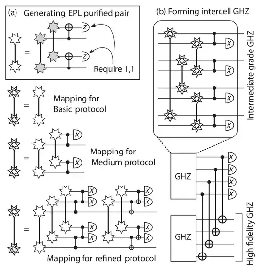

Construction of the purified GHZ state involves post-selection, as shown in the schematic below,
(All images in this post are from Nickerson, et al. Freely Scalable Quantum Technologies Using Cells of 5-to-50 Qubits with Very Lossy and Noisy Photonic Links. Phys. Rev. X 4, 041041 (2014).)
