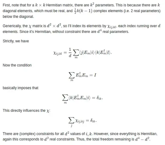

A post, Why does the $\chi$ matrix have $d^4-d^2$ independent parameters?, has been asked on this, which contains an answer by @DaftWullie, which make use of the Choi matrix,
post
where it seems like $\chi$ is used to represent the Choi matrix, not the $\chi$ matrix.

This directly influences the $\chi$: $$ \sum_j\chi_{ij,kj}=\delta_{ik} $$ There are (complex) constraints for all $d^2$ values of $i,k$. However, since everything is Hermitian, again this corresponds to $d^2$ real constraints. Thus, the total freedom remaining is $d^4-d^2$.
How do we obtain $\sum_j\chi_{ij,kj}=\delta_{ik}$ ?
How does imposing the trace-preserving condition $\sum_m E_m^\dagger E_m=I$ on the Choi matrix obtains the number of constraints on the $\chi$ matrix ?

Counting the number of free parameters of Choi operators
The number of independent parameters in the $\chi$ matrix is identical to the number of independent parameters in the Choi matrix, or in the channel itself, because these are all isomorphic representations of the same objects.
A map $\Phi$ acting on (the set of linear operators defined on) a Hilbert $H$ is a channel (meaning, it's completely positive and trace-preserving) iff its Choi representations, defined as $J(\Phi)\equiv\sum_{ij}\Phi(|i\rangle\!\langle j|)\otimes|i\rangle\!\langle j|$, is positive semidefinite and such that $\operatorname{tr}_1(J(\Phi))=I$.
The set of Hermitian operators on a Hilbert space $H$ is a vector space of (real) dimension $\operatorname{dim}(H)^2$. The set of positive semidefinite operators on a Hilbert space $H$ is a (compact, convex) subset of this space, and thus has the same number of independent parameters.
The set of Choi operators $J(\Phi)$ of channels $\Phi$ is a subset of the set of positive semidefinite operators on $H\otimes H$. It thus has $\dim(H\otimes H)^2=\dim(H)^4$ independent real parameters. However, the trace-preserving condition removes some of these degrees of freedom. The trace-preserving condition, which reads $\operatorname{tr}_1(J(\Phi))=I$, amounts explicitly to the $\dim(H)^2$ conditions: $$\sum_i J(\Phi)_{ij,ik}=\delta_{jk}, \qquad \forall j,k=1,...,\dim(H). $$ You can verify that these conditions are linearly independent, and thus remove $\dim(H)^2$ free parameters. You conclude that the set of Choi operators is a subset of $\operatorname{Lin}(H\otimes H)$ with $\dim(H)^4-\dim(H)^2$ free parameters.
