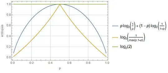

Here's a plot of the three quantities for the possible distributions over two outcomes:

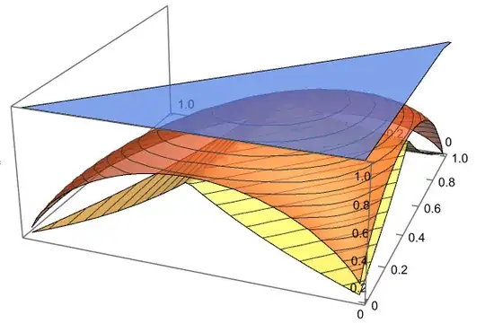

We can also do the same for three-outcome distributions, obtaining essentially the same result:

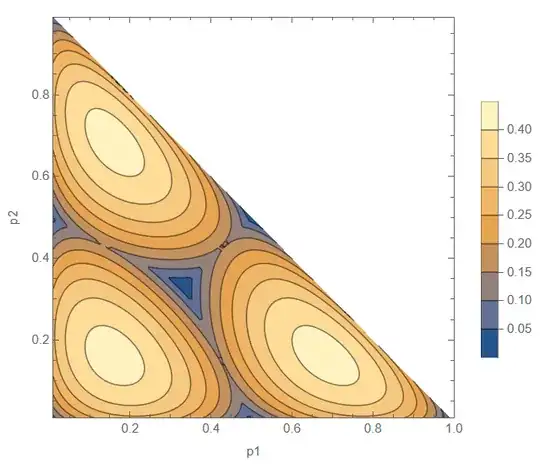

This is, however, significantly harder to parse without being able to rotate the figure. One way to see that the relations between $H,H_{\rm min},H_{\rm max}$ we had before remains here, is to show only the difference between $H$ and $H_{\rm min}$:
This clearly shows that $H\simeq H_{\rm max}$ whenever we have a balanced distribution, be it $P\simeq (1/3,1/3,1/3)$, or things like $P\simeq (1/2,1/2,0)$. But nearby this point, we also have $H\simeq H_{\rm min}$.
