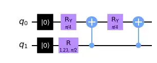

This is how you do it:
import numpy as np
from qiskit import QuantumCircuit, QuantumRegister, assemble, Aer
q = QuantumRegister(2, name = 'q') circuit = QuantumCircuit(q)
#Define initial state
initial_state = [1/np.sqrt(3), 1/np.sqrt(3),1/np.sqrt(3),0]
circuit.initialize(initial_state, [0,1])
circuit.decompose().decompose().decompose().decompose().decompose().draw("mpl")
