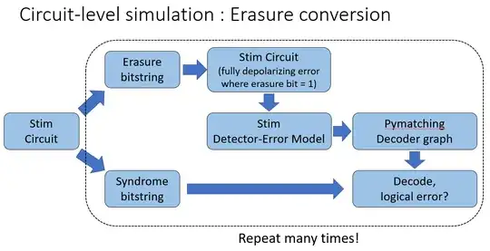

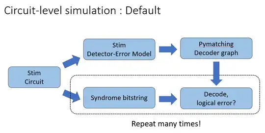

Adding my two cents on "finding a decoder that understands the erasures" - here are slides I made in the past, which seems to be valid for the newly updated HERALDED_ERASE feature in Stim as well. Thanks for adding this feature!
