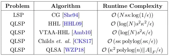

Let's talk now about the complexity analysis of HHL. From Quantum linear systems algorithms: a primer (Dervovic, Herbster, Mountney, Severini, Usher & Wossnig, 2018), the complexity of HHL (and several improvements) is written in the image below.
complexity of HHL
The complexity analysis does not take into account (at least I did not find it) the necessary knowledge on the eigenspectrum.
The case where the considered matrix has sufficiently good properties to estimate its eigenvalues analytically is uncommon (at least for real-world matrices) and is ignored.
In this answer, @DaftWullie uses the Gershgorin's circle theorem to estimate the upper and lower bounds of the eigenspectrum. The problem with this approach is that it takes $\mathcal{O}(N)$ operations ($\mathcal{O}(\sqrt{N})$ if amplitude amplification is applicable). This number of operation destroys the logarithmic complexity of HHL (and it's only advantage over classical algorithms in the same time).
Second group of questions: Is there a better algorithm in term of complexity? If not, then why is the HHL algorithm still presented as an exponential improvement over classical algorithms?

The restriction on the eigenvalues is usually given in the form of a condition number. This is the $\kappa$ that you see in all the runtimes in your table. $\kappa = |\lambda_{\rm{max}}/\lambda_{\rm{min}}|$ where $\lambda_{\rm{max}}$ and $\lambda_{\rm{min}}$ are the maximum and minimum eigenvalues respectively.
In all runtimes listed in your table, it is assumed that the condition number is known. One does not usually think of "calculating the condition number" as part of the algorithm for solving $Ax=b$, for example. If the condition number is larger, the system is harder to solve, and if it is smaller the system is easier to solve (assuming all other parameters, including the maximum desired error $\epsilon$ are held fixed).

Out of the 539 papers that have (at present) cited the original HHL paper, many of them will not know the finer details like the dependence of its performance on the condition number or eigenvalues. Some of the papers will certainly know that the performance of the algorithm will depend on the condition number or eigenvalues of the matrix, namely, the papers listed in your table on improvements to the HHL algorithm. Robin Kothari also mentioned it, for example, at the very beginning of his talk in 2016 on the CKS algorithm (which is mentioned in your table).
The algorithm you mention, suggested by DaftWulie, to estimate the bounds on the eigenvalues, is not going to be improved over $\mathcal{O}(\sqrt{N})$ because the dominant cost in that algorithm is in searching through all $N$ rows for the maximum and minimum values. The cost of everything else is small because the matrix is assumed to have a sparsity of $s \lll N$. There is no way to do this search faster in faster than $\mathcal{O}(\sqrt{N})$ time (unless you have some other extra knowledge of the system) because Grover's algorithm has been proven to be optimal.
You are right, people should mention the caveats of algorithms more often in their papers. In terms of your specific question "why is the HHL algorithm still presented as an exponential improvement over classical algorithms," I think the original authors HHL did do their due diligence in explaining the algorithm and its caveats, in that they said that there's an exponential scaling but the cost grows quadratically with the condition number and sparsity and inversely with the size of the error you are willing to tolerate. Why do most other people after HHL not mention all the caveats? Well many of them don't know the caveats, and those that do might have felt it wasn't necessary because calculating the condition number is not part of the algorithm. Knowing the condition number will tell you how well the algorithm will work, but it is assumed you already know this like in the molecular vibrations example I gave above!
