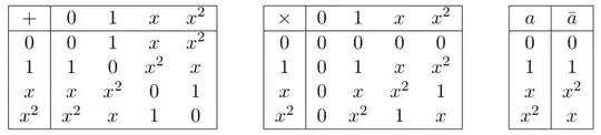

It is incorrect to use modulo arithmetic in this context. Instead finite field arithmetic should be applied. In $\textrm{GF}(4) = \{0, 1, x, x^2\}$ where $x^2 = x + 1$ and conjugation of $a$ is defined as $\bar{a} = a^2$.
Addition, multiplication and conjugation tables are then as follows:
In this picture we have $0 \equiv 0$, $1 \equiv 1$, $2 \equiv x$, and $3 \equiv x^2$ such that $2 \times 2 = 3$ and so the apparent inconsistency does not occur.
