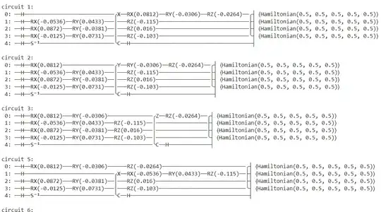

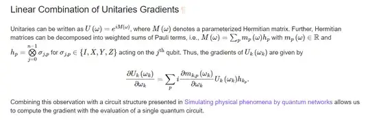

I'm trying to implement linear combination of unitaries(LCU) gradient from Qiskit Gradient Framework enter image description here but on PennyLane.

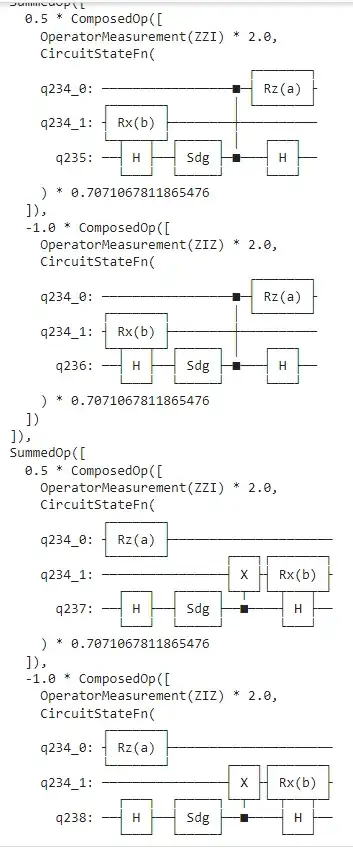

First, i looked through the source code in Qiskit. In Qiskit LCU gradient if we have 2 parameterized gate and 2 hamiltonian terms it will look like this
for each parameterized gate they use control unitary gate that unitary gate is same as parameterized gate (if parameterized gate is RZ it will be CZ) and calculate expectation value. So i tried to implement this on PennyLane like this
in this case i have 3 parameterized gates for each qubit. Expectation value of each circuit is gradient of each parameterized gate.
The code looks correct but the result when i use this gradient to do optimization is really bad. So i want to ask if there anything wrong in my idea of how LCU gradient work?
