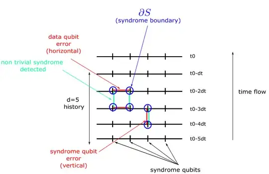

Where I struggle: we assume that the syndrome can also be faulty
When the syndrome can be faulty we have to include the time dimension in the reasoning (note: in what follow I assume a bit-flip code so that my surface is $1$-dimensional). The time dimension is vertical while the surface is represented horizontally. Data qubits errors are then horizontal line and syndrome qubit error vertical lines and they will always be written (as before) with the letter $E$. They will be in red colors. Places where a non trivial syndrome is detected (i.e we we are no longer in the $+1$ eigenstate of the associated syndrome) are in green colors. The associated chain will be written with the letter $S$. The boundary of those syndromes are in blue (written with the letter $\partial S$). Below is an image to clarify all this (with examples of errors occuring):
My question: how can we show that we necessarily have to store a history of $d$ cycle in order to be able to resist again error chains which total weight is $|\sum_i E_i| \leq (d-1)/2$? I would ideally be interested by a good pedagogic reference on this.

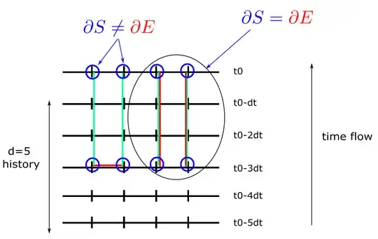

  1. The syndrome chain $S$ does not always verify $\partial S = \partial E$ in the case we take a finite slice of data (see an example in the image below). Because of that, condition that the recovery $R$ I apply should verify $\partial R = \partial S$ is not always correct. This fact confuses me in how we should reason. This issue will typically occur when the non trivial syndrome is reaching the time edges (at $t_0$ or at $t_0-5dt$).
  2. Should we keep in memory $d$ timesteps of error correction and then do a big correction or should we actually consider than when a non trivial syndrome is detected, we have to look at it for $d$ timesteps in order to differentiate between space and time errors? I guess it is a hint to solve my previous struggle but I am not sure...
An example where $\partial S \neq \partial E$ (on the left), and $\partial S = \partial E$ (on the right).

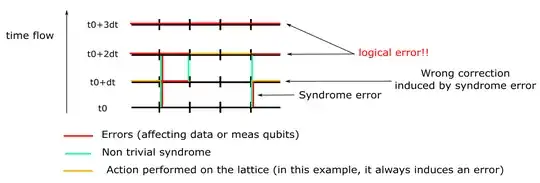

As suggested in Craig Gidney answer below, storing data in time might only be necessary if we perform non-trivial logical operations on the lattice. It is also said that errors in time are not dangerous for a quantum memory as they are in the up direction (while logical error are in the left-right direction). However, from my perspective, a time error could indirectly induce a space (i.e left to right) error, and hence be indirectly dangerous. Below is an attempt to show such example. I assume:
  1. For each clock cycle I have less (or equal) than $(d-1)/2$ errors which include measurement and data qubits.
  2. I perform correction "ASAP" (i.e I don't wait for $d$ clock cycle to do something, I perform corrections live).
  3. I apply a correction with minimum weight. Different corrections could be possible (and I consider in those examples the ones that would cause me troubles for the sake of illustration).
Comments on this image:
  • At $t_0$, the first and last (i.e fourth) syndrome have an error.
  • Because of that, at $t_0+dt$ I perform a (wrong) correction on first and last data qubits. It will induce an error on my lattice. On this new timestep, I can also have no more than $2$ errors. They happen to be on the first syndrome and second data qubit.
  • At $t_0+2dt$, the (correct) third and last syndromes are non-trivial. A possible minimum weight correction is to flip the third and fourth data qubits. It induces a logical error.
  • At $t_0+3dt$ the logical error stays.
Of course this example is not necessarily contradictory with the fact we can correct with $O(1)$ in the case of a quantum memory, but it illustrates my confusion. Having less (or equal) than $(d-1)/2$ errors, "live" correction induces a logical error. For this reason the code distance cannot anymore be $d$.
Would it be possible to have an intuitive algorithm that shows how we can correct in the quantum memory case when the syndrome happen to be faulty?

I don't know a hard rule for how many rounds you need to keep in memory. For example, suppose you were using phenomenological noise with an extremely low data error rate of 1 in a billion but an extremely high measurement error rate of 49.99%. One way to deal with this is to fold together a million rounds into one super-round and do majority voting for the super-round measurement results. Each super-round has an effective measurement error rate of 2.5% and a data error rate of 0.1%. That's pretty reasonable so you'd use 'standard techniques' on the super-rounds, keep 50 or 100 of them in memory or whatever. But now your history is effectively going to span tens of super-rounds, which is tens of millions of the original rounds, to achieve a code distance of (say) 5!
That being said, to me the key problem that jumps out when you have $r < d$ rounds of memory is that a chain of $r$ measurement errors can create a pair of detection events separated by enough time that only one is in memory at a time. And if there's only one in memory, you are forced to match it to a spatial boundary. So suppose these measurement errors are happening next to the center of the patch, and then one additional data error at the future side pushes the future detection event across the center. On the past side you will match to one boundary and on the future side you will match to the other, completing an error chain across the patch (which is a logical error).
