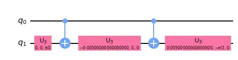

My question is if the lower bound coming from the geometric complexity is anywhere near tight? Naively, the two complexity measures can be far apart. For example take a 2q unitary, a controlled $rx$ gate with a small angle:
It's exact compilation according to $KAK$ decomposition requires two CNOTs:
So this gives discrete complexity 2 even for small values of the rotation gate. I do not know the geometric complexity for this circuit, but since it must be continuous and given that the gate is sufficiently close to the identity I expect the geometric complexity to be small (also here https://arxiv.org/abs/2104.03332 it is proven that entangling power lower bounds the geometric complexity with the bound being tight for small values, and my gate definitely has very low entangling power).
