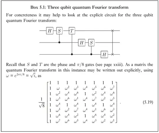

I am currently going through Nielsen's QC bible and having still some foundational / conceptual problems with the matter.
Nielsen Quantum Computing
I have tried to retrieve this $8 {\times} 8$ matrix describing the QFT of 3 qubits via Kronecker product in various attempts.
Hadamard transform can be decomposed into $H \otimes 1 \otimes 1$, and the others are fundamentally kronecker products of the 4x4 matrices of S resp. T with the 2x2 identity.
Whats wrong with my approach?
EDIT:
$T\text{=}\left( \begin{array}{cccccccc} 1 & 0 & 0 & 0 & 0 & 0 & 0 & 0 \\ 0 & 1 & 0 & 0 & 0 & 0 & 0 & 0 \\ 0 & 0 & 1 & 0 & 0 & 0 & 0 & 0 \\ 0 & 0 & 0 & 1 & 0 & 0 & 0 & 0 \\ 0 & 0 & 0 & 0 & 1 & 0 & 0 & 0 \\ 0 & 0 & 0 & 0 & 0 & e^{\frac{\pi i}{4}} & 0 & 0 \\ 0 & 0 & 0 & 0 & 0 & 0 & 1 & 0 \\ 0 & 0 & 0 & 0 & 0 & 0 & 0 & e^{\frac{\pi i}{4}} \\ \end{array} \right)$
which is derived from $R_k = \left( \begin{array}{cc} 1 & 0 \\ 0 & e^{2 i \pi /2^k} \\ \end{array} \right)$, being $S$ for $k=1$ and $T$ for $k=2$.
EDIT 2:
The controlled T-operation can be represented in computational basis as
$\left( \begin{array}{cccc} 1 & 0 & 0 & 0 \\ 0 & 1 & 0 & 0 \\ 0 & 0 & 1 & 0 \\ 0 & 0 & 0 & e^{2 \pi i / 2^k } \\ \end{array} \right)$.
EDIT 3:
In mathematica, one faulty calculation of mine is:
$\text{SWAP}\text{=}\left( \begin{array}{cccccccc} 1 & 0 & 0 & 0 & 0 & 0 & 0 & 0 \\ 0 & 0 & 0 & 0 & 1 & 0 & 0 & 0 \\ 0 & 0 & 1 & 0 & 0 & 0 & 0 & 0 \\ 0 & 0 & 0 & 0 & 0 & 0 & 1 & 0 \\ 0 & 1 & 0 & 0 & 0 & 0 & 0 & 0 \\ 0 & 0 & 0 & 0 & 0 & 1 & 0 & 0 \\ 0 & 0 & 0 & 1 & 0 & 0 & 0 & 0 \\ 0 & 0 & 0 & 0 & 0 & 0 & 0 & 1 \\ \end{array} \right)$
SWAP*KroneckerProduct[IdentityMatrix[2], IdentityMatrix[2], H]KroneckerProduct[IdentityMatrix[2], S] KroneckerProduct[ IdentityMatrix[2], H, IdentityMatrix[2]] * T KroneckerProduct[S, IdentityMatrix[2]] KroneckerProduct[H, IdentityMatrix[2], IdentityMatrix[2]] // MatrixForm
which gives:
$\left( \begin{array}{cccccccc} \frac{1}{2 \sqrt{2}} & 0 & 0 & 0 & 0 & 0 & 0 & 0 \\ 0 & 0 & 0 & 0 & 0 & 0 & 0 & 0 \\ 0 & 0 & -\frac{1}{2 \sqrt{2}} & 0 & 0 & 0 & 0 & 0 \\ 0 & 0 & 0 & 0 & 0 & 0 & 0 & 0 \\ 0 & 0 & 0 & 0 & 0 & 0 & 0 & 0 \\ 0 & 0 & 0 & 0 & 0 & \frac{e^{\frac{i \pi }{2}}}{2 \sqrt{2}} & 0 & 0 \\ 0 & 0 & 0 & 0 & 0 & 0 & 0 & 0 \\ 0 & 0 & 0 & 0 & 0 & 0 & 0 & -\frac{e^{\frac{i \pi }{2}} i^2}{2 \sqrt{2}} \\ \end{array} \right)$

The tensor products for the individual gates are all being calculated correctly, and the matrices are being multiplied in the correct order. In this case, it turns out that it is a Mathematica programming error, using the * operator for element-by-element multiplication of matrices rather than matrix multiplication. The first clue was that the overall output was not even unitary, even though the individual gates seemed to be correct.
