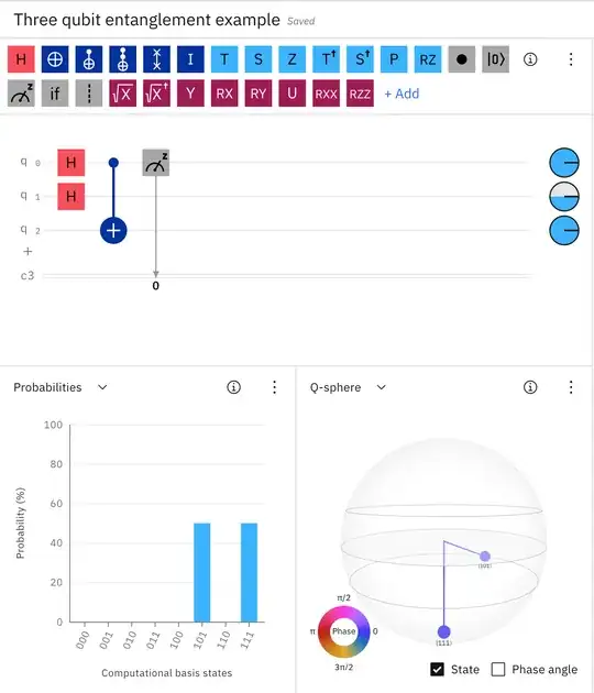

If you consider only the first and the second qubits then they are not entangled in the sense that knowing the state of one qubit is not sufficient to make any prediction on the state of the other qubit, because there is equal probability of either possibility. The same can be said about the pair of the second qubit and the third qubit. But the first qubit and the third qubit are entangled, which means if you know the state of one of them then the state of the other qubit would be determined.
Here is a Qiskit circuit for the same:
You can see that by measuring the first qubit, the state of second qubit has equal probability of being either $|0\rangle$ or $|1\rangle$.
