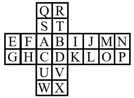

Consider the four cells on each of the six faces of the 2x2x2 Rubik's cube (the pocket cube). We can construct and simulate a quarter-turn Hamiltonian as below. $^*$
Pocket Cube Layout
Let $\langle F_1,U_1,R_1\rangle$ be the quarter-turn moves that rotate each of the front face, the upper face, and the right face in the clockwise direction. Similarly let $\langle F_3,U_3,R_3\rangle$ be the counter-clockwise generators; let the half-turns be $\langle F_2,U_2,R_2\rangle.$

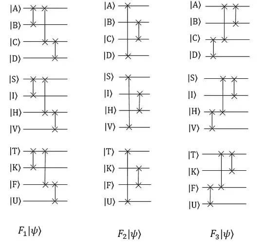

Moves of the Front Face
If we hold the cube such that the face with cells $\mathrm{A},\mathrm{B},\mathrm{C},\mathrm{D}$ is in the front, we have the SWAP circuits for example as above. Each of $F_1,F_2,F_3$ act on twelve qudits, where each of $\vert\mathrm{A}\rangle,\vert\mathrm{B}\rangle,\ldots,\vert\mathrm{V}\rangle$ are registers that can be in a superposition of six different colors; thus the pocket cube has natural $k=12$-local, $d=6$-dimensional Hamiltonian $\mathcal{H}$. Both $F_1$ and $F_3$ use nine SWAPs, while $F_2$ only uses six.

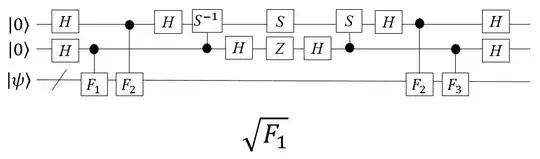

We know that the order of each of the quarter-turn moves is four, and we can use this to construct circuits for the square-root of a quarter-turn move.
Square Root of F1
Indeed, following the recipe outlined in this question, we can prepare circuits for the roots of each generator; $\sqrt{F_1}$ is an example as above. This uses $9+6+6+9=30$ controlled-SWAP (CSWAP) gates with $H$ and $S$ gates for the quantum phase estimation. The two reusable ancillae store the phases of the eigenspace, while $\vert\psi\rangle$ is a register of $24$ six-dimensional qudits (or $24\times 3=72$ qubits).
