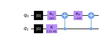

As Martin Vesely mentioned in the comments, you can use the initialize function to perform such a task. For instance, to create the state you desire, you can do the following:
import numpy as np
from qiskit import QuantumCircuit
from qiskit.transpiler.passes import Decompose
qc = QuantumCircuit(2) initial_state = np.array([1, 1, 0, 1], dtype=float) initial_state /= np.linalg.norm(initial_state) qc.initialize(initial_state) qc.decompose().decompose().decompose().decompose().draw("mpl")
which draws the following output:
Decomposed circuit
To know how does qiskit create this unitary, have a look at this answer.
