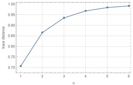

For example, if you take $\rho=|0\rangle\!\langle0|$ and $\sigma=|+\rangle\!\langle+|$ and compute the trace norm $\|\rho^{\otimes n}-\sigma^{\otimes n}\|_1$ as a function of $n$ (which you'll remember from the linked post, and the discussion in this post, gives you the maximum distinguishing probability), you get

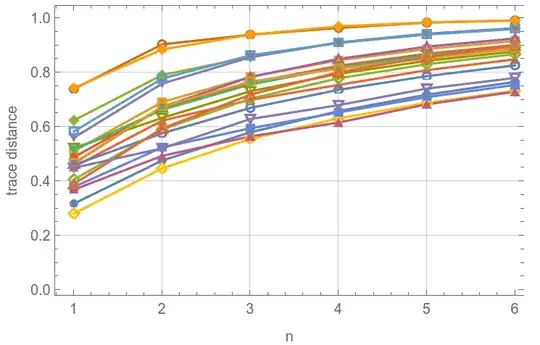

If you do the same for randomly generated three-dimensional states, you always get a similar behaviour:
