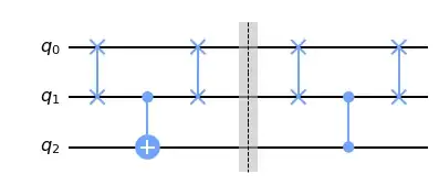

Let us consider a simple example, a CNOT gate
Assume that you can only apply two-quit gates between $q_0,q_1$ and $q_1,q_2$. Then this circuit could be made compatible with this connectivity by adding some SWAPs
Even if in the initial layout your control qubit was mapped to $q_0$ after the first SWAP it sits at $q_1$. Yes, we can then perform our CNOT and return the state of the control qubit back to $q_0$ (by the second SWAP, as shown on the image), but this might not be efficient. Suppose that you want to make two gates between $q_0$ and $q_2$, like here
If you insist that your initial layout be restored after each logical gate you can do it as follows (at the barrier the initial layout is restored)
However, this is obviously inefficient as the two subsequent SWAPs combine to an identity.
OK, so qiskit has a lot of clever algorithms to avoid this kind inefficiency and thy involve frequent rearrangements of logical qubits. Initial layout simply determines how do you start. If you still insist on keeping the layout fixed you should probably explain why and, in the case of constrained connectivity, in what sense?
