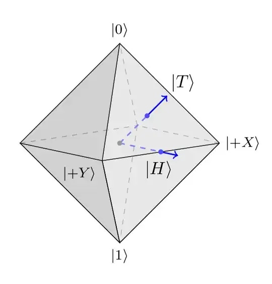

It becomes very simple when you look at it in the Bloch representation
Stabiliser polytope with magic states
(Figure by me. Ref: Robustness of Magic and Symmetries of the Stabiliser Polytope)
The depicted octahedron is the polytope spanned by the 1-qubit stabiliser states (the Pauli eigenstates) and sits inside the Bloch sphere.
The Clifford group is exactly the symmetry group of the stabiliser polytope,* i.e. it is generated by $\pi/2$ rotations around the $X$, $Y$, and $Z$ axis.
You can see that the $|T\rangle$ state is normal to a facet of the stabiliser polytope. This is preserved under the Clifford orbit and since there are in total 8 facets, we have 8 $|T\rangle$ states.
$|H\rangle$ is normal to an edge. Through the Clifford action, you can reach any edge and there are in total 12 of them.
*It is the symmetry group within $\mathrm{SO}(3)$. Additionally, there are reflections, which come from an anti-unitary extension of the Clifford group. See App. C in Robustness of Magic and Symmetries of the Stabiliser Polytope.
