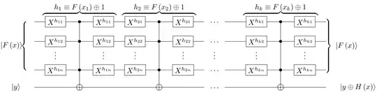

My implementation of $H$
The paper doesn't mention the implementation of $H$ apart from stating that $H$ can be implemented with only one query to $F$. However, implementing a general $H$ seems like it would give rise to a large complexity cost. Below is the best implementation of general $H$ I could think of:
where $h_{ij}$ denotes the $j^\text{th}$ bit of the $n$-bit string $h_i$
If we denote the action of the above circuit by $U_H|F\left(x\right)\rangle|y\rangle=|F\left(x\right)\rangle|y\oplus H\left(x\right)\rangle$ then:
As a Toffoli gate can be implemented with 15 1,2-qubit gates and an $n$-bit controlled $X$ gate requires $2n$ Toffoli gates and an $X$ gate then $U_H$ is implemented by $\left(32n+1\right)k$ 1,2-qubit gates. Clearly not all the $X$ gates in $U_H$ are required as if $h_{ij}=0$ then the corresponding two $X$ gates can be removed. In addition, $X^2=I$ so the $\left\{h_i\right\}$ could be ordered to take advantage of this. But still, we can upper bound the complexity of $U_H$ as $\mathcal O\left(nk\right)$.

Question
So presumably there is a better implementation of $U_H$ than I have given as the paper has better time complexity. My question is what is this implementation of $U_H$?

I have come up with a proof that the best complexity with which $U_H$ can be implemented is $\mathcal O\left(nk\right)$ and so my implementation of $U_H$ is optimum up to a constant factor in complexity.
Proof
The output $|y\oplus H\left(x\right)\rangle$ must depend on each $F\left(x_i\right)$ in $L$ and in turn each bit in $F\left(x_i\right)$ so we must perform at least $nk$ comparisons with 2-qubit gates minimum. One might attempt to argue if we pre-sort $L$ then we can use some classical optimisation such as a binary search where if-then-else statements are used to reduce the number of operations taken to compare the input to the elements in $L$; but in a unitary operation, such flow controls are implemented by controlled gates where both the controlled gate for the then and else are still carried out because in general the condition for if is a state in superposition and thus we still compare all $nk$ bits. If we wished to cut out the gates from the then or else executions we would first need to measure which would then prevent the circuit from being unitary and we require $U_H$ to be unitary for Grovers algorithm. Therefore, this imposes a lower bound on the complexity of $\mathcal O\left(nk\right)$.
