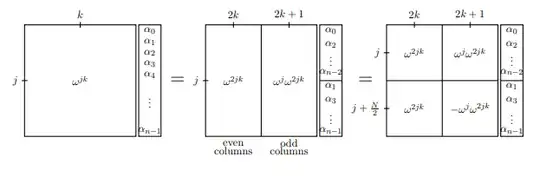

The Fast fourier transform:
Now, let us look at the Fast fourier transform. The fast Fourier transform uses the symmetry of the Fourier transform to reduce the computation time. Simply put, we rewrite the Fourier transform of size $N$ as two Fourier transforms of size $N/2$ - the odd and the even terms. We then repeat this over and over again to exponentially reduce the time. To see how this works in detail, we turn to the matrix of the Fourier transform. While we go through this, it might be helpful to have $\text{DFT}_8$ in front of you to take a look at. Note that the exponents have been written modulo $8$, since $w^8 = 1$.
Notice how row $j$ is very similar to row $j + 4$. Also, notice how column $j$ is very similar to column $j + 4$. Motivated by this, we are going to split the Fourier transform up into its even and odd columns.
In the first frame, we have represented the whole Fourier transform matrix by describing the $j$th row and $k$th column: $w^{jk}$. In the next frame, we separate the odd and even columns, and similarly separate the vector that is to be transformed. You should convince yourself that the first equality really is an equality. In the third frame, we add a little symmetry by noticing that $w^{j+N/2} = −w^j$ (since $w^{n/2} = −1$).
Notice that both the odd side and even side contain the term $w^{2jk}$. But if $w$ is the primitive Nth root of unity, then $w^2$ is the primitive $N/2$ nd root of unity. Therefore, the matrices whose $j$, $k$th entry is $w^{2jk}$ are really just $\text{DFT}_{(N/2)}$! Now we can write $\text{DFT}_N$ in a new way: Now suppose we are calculating the Fourier transform of the function $f(x)$. We can write the above manipulations as an equation that computes the jth term $\hat{f}(j)$.
Note: QFT in the image just stands for DFT in this context. Also, M refers to what we are calling N.
This turns our calculation of $\text{DFT}_N$ into two applications of $\text{DFT}_{(N/2)}$. We can turn this into four applications of $\text{DFT}_{(N/4)}$, and so forth. As long as $N = 2n$ for some $n$, we can break down our calculation of $\text{DFT}_N$ into $N$ calculations of $\text{DFT}_1 = 1$. This greatly simplifies our calculation.
In case of the Fast fourier transform the time complexity reduces to $\mathcal{O}(N\log(N))$ (try proving this yourself). This is a huge improvement over the classical DFT and pretty much the state-of-the-art algorithm used in modern day music systems like your iPod!

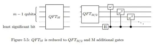

The Quantum Fourier transform with quantum gates:
The strength of the FFT is that we are able to use the symmetry of the discrete Fourier transform to our advantage. The circuit application of QFT uses the same principle, but because of the power of superposition QFT is even faster.
The QFT is motivated by the FFT so we will follow the same steps, but because this is a quantum algorithm the implementation of the steps will be different. That is, we first take the Fourier transform of the odd and even parts, then multiply the odd terms by the phase $w^{j}$.
In a quantum algorithm, the first step is fairly simple. The odd and even terms are together in superposition: the odd terms are those whose least significant bit is $1$, and the even with $0$. Therefore, we can apply $\text{QFT}_{(N/2)}$ to both the odd and even terms together. We do this by applying we will simply apply $\text{QFT}_{(N/2)}$ to the $n-1$ most significant bits, and recombine the odd and even appropriately by applying the Hadamard to the least significant bit.
Now to carry out the phase multiplication, we need to multiply each odd term $j$ by the phase $w^{j}$ . But remember, an odd number in binary ends with a $1$ while an even ends with a $0$. Thus we can use the controlled phase shift, where the least significant bit is the control, to multiply only the odd terms by the phase without doing anything to the even terms. Recall that the controlled phase shift is similar to the CNOT gate in that it only applies a phase to the target if the control bit is one.
Note: In the image M refers to what we are calling N.
The phase associated with each controlled phase shift should be equal to $w^{j}$ where $j$ is associated to the $k$-th bit by $j = 2k$. Thus, apply the controlled phase shift to each of the first $n − 1$ qubits, with the least significant bit as the control. With the controlled phase shift and the Hadamard transform, $\text{QFT}_N$ has been reduced to $\text{QFT}_{(N/2)}$.
Note: In the image, M refers to what we are calling N.
