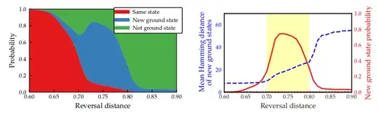

This introduces the new parameter reversal distance which determines how far you want to anneal backward (how strong the transverse field should become). D-Wave published the following two plots in this D-Wave Whitepaper:
reversal distance plots
In the left plot you can see that reversal distance is a very important new hyperparameter since its value determines the probability of obtaining a new ground state (blue region). If the reversal distance is too low, you will get the same state you started with (red region) which would be useless. And of course if you reverse anneal for too long you essentially perform traditional quantum annealing and loose the information that you started with. Remember that too much transverse field means that we are performing global search again!
The right plot shows essentially the same thing by plotting Hamming distance against reversal distance and the probability of obtaining a new ground state. For your problem at hand, you want to find that sweet spot (maxima of the red curve). For large reversal distances we again see that we get solution strings that are far from our initial state in terms of Hamming distance.
