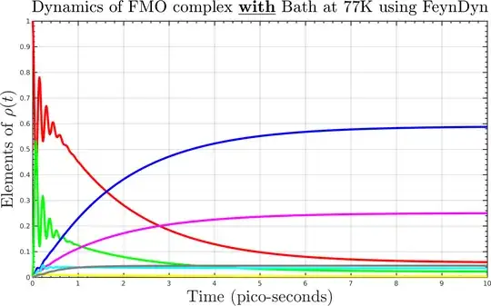

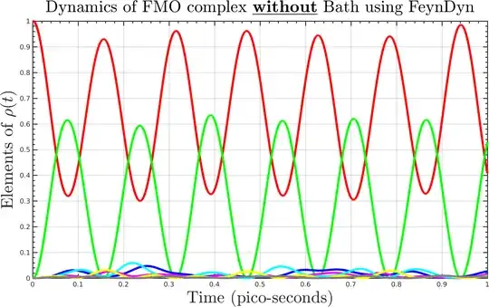

The environment/bath does assist the energy transfer, because without it you would have infinitely long Rabi oscillations:
By coupling to the bath, we get damped Rabi oscillations that get localized on the lowest-energy site (known as the "sink") which couples to the reaction center that the excitation needs to get to for photosynthesis:
Isn't that beautiful how none of the excitation was getting to the blue site without the bath, but simply by turning on the bath we get a major energy transfer from antenna to reaction center?
All calculations were done in Octave using Nike Dattani's FeynDyn (Feynman Dynamics) code:

5) On line 51 make J = 0, for no coupling to bath, press F5 again.
You can change the temperature, spectral density, and Hamiltonian parameters and get slower and faster energy transfer rates, and you will quickly see why the crystal structure parameters used in this simulation are not optimal, and why it is going to be impossible even for a quantum computer to find THE optimal transfer rate.
