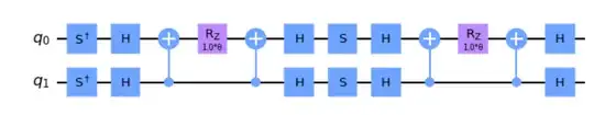

If you want to use more basic gates than rxx and ryy, you can use Qiskit's Operator Flow:
H = 0.5 * ((X^X) + (Y^Y))
theta = Parameter('θ')
evolution_op = (theta * H).exp_i() # exp(-iθH)
trotterized_op = PauliTrotterEvolution(trotter_mode = Suzuki(order = 1, reps = 1)).convert(evolution_op) circuit = trotterized_op.to_circuit() circuit.draw('mpl')
The composition: enter image description here And as before
param_iswap = circuit.to_gate()
