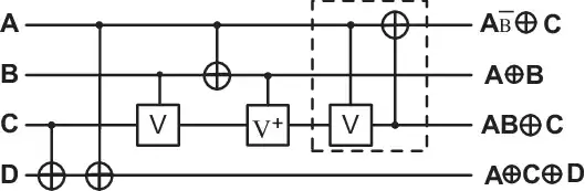

I have come across most of the quantum circuit which contains gate such as controlled $V$ and $V^{\dagger}$ but I dont know how to code it in Qiskit.
The above image is the zplg gate circuit

$V$ is the square root of $X$. That is,
\begin{align*} V = \sqrt X = \frac{1}{2}\left( {\begin{array}{*{20}{c}} {1 + i}&{1 - i}\\ {1 - i}&{1 + i} \end{array}} \right) \end{align*}

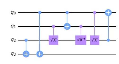

It is implemented in Qiskit with the name $SX$. So, the circuit in your question is easy to implement:
from qiskit import QuantumCircuit
from qiskit.circuit.library import SXdgGate
qc = QuantumCircuit(4)
qc.cx(2, 3) qc.cx(0, 3)
qc.csx(1, 2) qc.cx(0, 1)
csxdg_gate = SXdgGate().control() qc.append(csxdg_gate, [1, 2])
qc.csx(0, 2) qc.cx(2, 0)
qc.draw('mpl')
