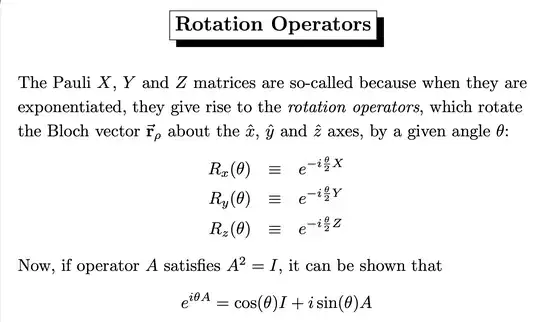

Why I am concerned about the above unitary operator is: d Please see the below definition for the rotation operators. Here there is an imaginary $i$ coming which is not in the paper I have mentioned.

Setting $\theta=\pi/2$ for a general rotation, you get $$ \mathrm{e}^{-\mathrm{i}\pi/2 A} = \mathrm{i} A\,, $$ which is unitary and up to a global phase $\mathrm{i}$ the operator $A$ itself. Now define a new operator $U=-\mathrm{i}A$ and it follows that $U$ is unitary $$ U^\dagger U = \mathrm{i}(-\mathrm{i}) A^\dagger A = I\,. $$
You can decompose $A$ into $$ A = n_x \sigma_x + n_y \sigma_y + n_z \sigma_z $$ with $$ n_x^2 + n_y^2 + n_z^2 = 1 $$ and $n_i \in[-1,1]$, $i=x,y,z$. In your example $$ n_x = \sin\left(\frac{7\pi}{8}\right) \qquad n_y = 0 \qquad n_z = \cos\left(\frac{7\pi}{8}\right)\,. $$ For more details see Nielsen and Chuang, Quantum Computation and Quantum Information.
