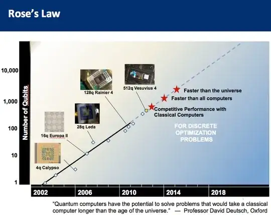

It is termed Rose's Law, by some; after the CTO of D-Wave Systems. See this article: "Quantum computing Rose’s Law is Moore’s Law on steroids" or the Flickr page of the Managing Director of the investment firm Draper Fisher Jurvetson, Steve Jurvetson: "Rose’s Law for Quantum Computers".
Rose's Law
The chart runs a bit ahead of itself, and it applies to quantum annealing computers, it's not exactly comparable to universal quantum computing.
The reason Moore's Law is not exactly comparable is because it refers to transistors and an entirely different manufacturing process, you're comparing a manufacturing process that was established at the time with one where the computer is in it's earliest days and is essentially hand built.

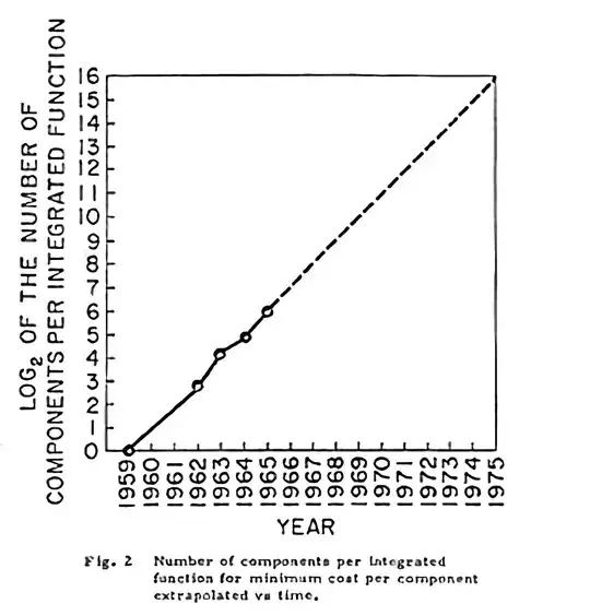

Gordon E. Moore's graphic from 1965 looked like this:
Original Moore's Law

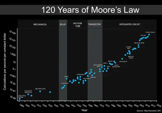

Moore's Law was well received, evolving into many things, like Kurzweil's "The Law of Accelerating Returns". Here's an updated version of Moore’s Law (based on Kurzweil’s graph):
Kurzweil's Law

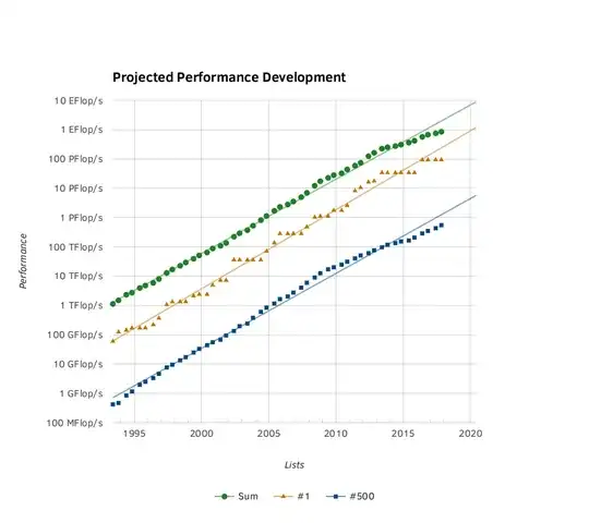

Another fact-based chart is provided by Top500.Org's chart of the exponential growth of SuperComputer power: Top 500 SuperComputers

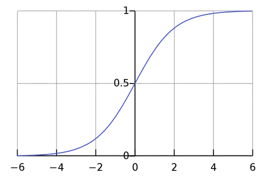

The Missouri University of Science and Technology's article: "Forecasting Consumer Adoption of Technological Innovation: Choosing the Appropriate Diffusion Models for New Products and Services before Launch" explains that the Bass Model (a modification of the logistic curve) is a sound method to predict future growth (based upon past statistics).
The logistic curve features a slow start, great mid-term progress, followed by an eventual slowdown; often replaced by something new.
Logistic Curve

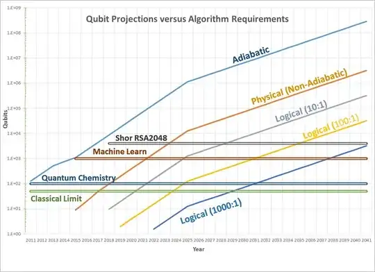

This article seems to adequately explain what you are asking. It shows the growth of usable qubits in quantum computers.
So the question comes up whether Moore’s Law can also be applied to quantum qubits. And early evidence suggests that indeed it may [...]
The adiabatic line would be a prediction for quantum annealing machines like the D-Wave computers. These have followed the Moore’s Law prediction pretty closely so far with the D-Wave 1 at 128 qubits in 2011, the D-Wave 2 at 512 qubits in 2013, the D-Wave 2X at 1097 qubits in 2015, and a 2048 qubit machine in 2017. [...]
The Physical curve predicts the number of physical qubits that will be available. There is less historical data on these, but there are indications that these will progress rapidly too. As examples, IBM has a 5 qubit machine that is available in the cloud through the IBM Quantum Experience and Google has demonstrated a 9 qubit machine. Both of these companies, and others have indicated that these densities will increase rapidly so the Physical curve maintains the improvement rate of a doubling every year for the next 10 years and a doubling every two years thereafter.
