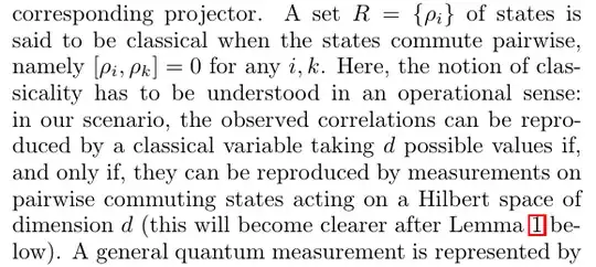

In quantum information it is commonly said that a set of states $S=\{ \rho_i \}_i$ is classical if $[\rho_m, \rho_n] = 0, \,\forall \rho_m,\rho_n \in S$. This is meant in the sense that all observed behaviors (results from quantum measurements on the states in $S$) could be reproduced by using only a classical variable. Additionally, if the support of $S$ has dimension $d$, you would only need (classical) dits to do so.
What is a good justification for this? Is this considered a definition or is it really a result?

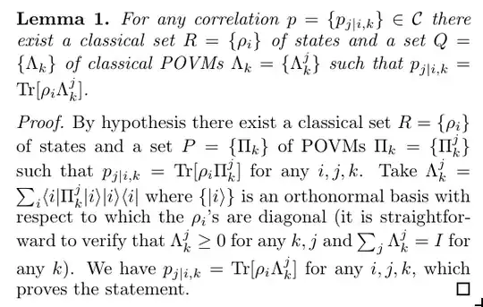

Edit: as asked, here is an example of the affirmation made in the first paragraph (taken from https://arxiv.org/abs/1207.2574):
classical reproduction of behaviors
The lemma in question is below. But as far as I understand, it only shows that given the assumption that the probabilities are reproducible with classical (i.e. pair-wise commuting) states, then "classical measurements" (defined likewise) are also enough. Am I missing something here?
lemma
cab20

I think the point of this definition is that if the states commute then there is no need for Alice to actually send quantum states to Bob. She might as well just send a classical message. Indeed, the authors point out after Lemma 1 that
Lemma 1 thus proves that every set of probabilities obtained with commuting states can be performed with classical states and classical POVMs. This clearly implies that commuting states may be equally regarded as classical variables, and commuting-element measurements as read-out of classical variables.
A possible argument to see why this is the case, loosely inspired by the proof of Lemma 1 (though in fairness I haven't really read the paper or the lemma in depth), is the following. If the states are pairwise commuting, $[\rho_i,\rho_j]=0$, then they can be simultaneously diagonalised: $$\rho_i = \sum_\ell \lambda_{i\ell}|\ell\rangle\!\langle \ell|,$$ for some $\lambda_{i\ell}\ge0$ and an orthonormal basis $\{|\ell\rangle\}_\ell$. We then have $$p_{j|i,k}=\operatorname{Tr}[\rho_i \Pi^j_k] = \sum_\ell \lambda_{i\ell} \langle \ell|\Pi^j_k|\ell\rangle.$$ What this is telling you is that, to reproduce the correlation, it is enough for Alice to send a classical message, and more specifically the value of $i$, to Bob's device. Bob's device will then sample one of the (fixed beforehand) states $|\ell\rangle$, with probabilities $\lambda_{i\ell}$, and measure it with the POVM $\{\Pi^j_k\}_j$, obtaining an outcome $j$.
