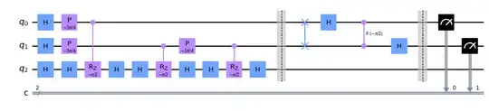

Re-edit:I start with the first question and I use an example. I know that every hermitian matrix could be written as $e^{-iAt}$, using Pauli Gates. If I have the following matrix $ A=\begin{bmatrix} 1&-\frac{1}{3}\\ -\frac{1}{3}&1\\ \end{bmatrix}$, I can write it as $A=-\frac{1}{3}X+\mathbb{1} $, so the exponential matrix is $e^{-iAt}=e^{-i(-\frac{1}{3}X+\mathbb{1})t}=e^{-i(-\frac{1}{3}X)t}e^{-i(\mathbb{1})t}$, I can write the last equality because the two operator commute. I want to write this in terms of gates, following the instruciton of previous posts I can write the term $e^{-i(\mathbb{1})t}$ as U1(-t) on control qubit. For $e^{-i(-\frac{1}{3}X)t}$, I know that $e^{-i(X)t}$ is equal to $HR_z(2t)H$,so, in my case, I can write $e^{-i(-\frac{1}{3}X)t}=HR_z(-2\frac{t}{3})H$

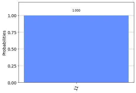

I tried to implement in qiskit the circuit, I find 100% of probability to have |11>, but I expect to have 100% of probability to have |10>, what am I doing wrong?
This is my code
t=2*np.pi*3/8
qpe = QuantumCircuit(3, 2)
qpe.h(2) #inizializzo il vettore (1,1) con H gate
for qubit in range(2):
    qpe.h(qubit)     #applico H gate ai control bit
repetitions = 1
for counting_qubit in range(2):
    for i in range(repetitions):
        qpe.p(-t,counting_qubit)
        qpe.h(2)
        qpe.crz(-2/3*t,counting_qubit,2)
        qpe.h(2)
        repetitions *= 2
qpe.barrier();
qpe.draw()
def qft_dagger(qc, n): """n-qubit QFTdagger the first n qubits in circ""" # Don't forget the Swaps! for qubit in range(n//2): qc.swap(qubit, n-qubit-1) for j in range(n): for m in range(j): qc.cp(-math.pi/float(2**(j-m)), m, j) qc.h(j)
Apply inverse QFT
qft_dagger(qpe, 2) #Measure qpe.barrier() for n in range(2): qpe.measure(n,n) qpe.draw()
My circuit enter image description here
My result on simulator
Re-edit: I noticed that if I remove the minus sign to the gates, the result is correct, but I don't understand why
Simona99
  • 328
i did the hamiltonian simulation with minus sign, but in QPE, I don't have to consider it
