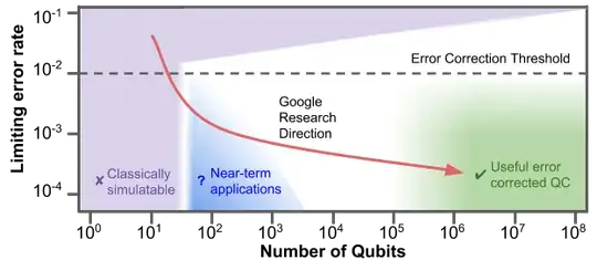

Another way to think about this: What would an update to this 2018 graph from Google AI Blog look like?
2D conceptual chart showing the relationship between error rate and number of qubits. The intended research direction of the Quantum AI Lab is shown in red, where we hope to access near-term applications on the road to building an error corrected quantum computer.

The most rigorous definition of NISQ that I've come across resides in The Complexity of NISQ, where the authors define the NISQ complexity class. This class contains a set of problems solvable by a BPP machine with access to a device that only has noisy quantum gates, noisy state preparation at the start and noisy measurements at the end of the program. The prevention of mid-circuit measurements or reset gates prevent this device from doing FTQC.
The authors were then able to prove that NISQ is weaker than BQP and stronger than BPP via oracle separations. They're lots of complexity-theoretical kinks that need to be worked out with this definition, but it's the best we have as far as I'm aware. Notice that specific qubit counts or error rates are not mentioned.
Regarding your "unpacking" questions, trying to get a handle on the comparisons of physical and logical qubits, comparisons which are descendants of discussions about NISQ vs FTQC, can get messy. Starting from the application and replacing the physical vs logical qubit distinction with number of qubits at a certain error rate is neater.
Let's consider the problem RCS is trying to solve. RCS is typically used to demonstrate that a quantum computer can do some task better than existing classical computers. We haven't needed error correction to accomplish this. Recent experiments from Google e.t al. and Quantinuum e.t al is enough evidence.
Now, if we were trying to solve a different problem, say, trying to demonstrate the minimum viable application of some scientific interest better than existing classical computers, that could be, for example, simulating the 2D transverse field Ising model. This will require something on the order of 200 qubits at a $10^{-11}$ error rate. The resource requirements for this application will go down significantly, but it's unlikely that they will be low enough for us to get away from performing QEC in order to run it.
