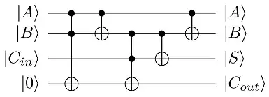

Quantum version of the full adder
Shown in figure 2, a simple way of doing this for single bits is by using $4$ qubit registers, here labelled $A$, $B$, $C_{in}$ and $1$, where $1$ starts in state $\left|0\right>$, so the initial state is $\left|A\right>\left|B\right>\left|C_{in}\right>\left|0\right>$:
  1. Apply Toffoli using $A$ and $B$ to control $1$: $\left|A\right>\left|B\right>\left|C_{in}\right>\left|A\cdot B\right>$
  2. CNOT with $A$ controlling $B$: $\left|A\right>\left|A\oplus B\right>\left|C_{in}\right>\left|A\cdot B\right>$
  3. Toffoli with $B$ and $C_{in}$ controlling $1$: $\left|A\right>\left|A\oplus B\right>\left|C_{in}\right>\left|A\cdot B\oplus\left(A\oplus B\right)\cdot C_{in} = C_{out}\right>$
  4. CNOT with $B$ controlling $C_{in}$: $\left|A\right>\left|A\oplus B\right>\left|A\oplus B\oplus C_{in} = S\right>\left|C_{out}\right>$
A final step to get back the inputs $A$ and $B$ is to apply a CNOT with register $A$ controlling register $B$, giving the final output state as $$\left|\psi_{out}\right> = \left|A\right>\left|B\right>\left|S\right>\left|C_{out}\right>$$
This gives the output of register $C_{in}$ as the sum and the output of register $2$ as carry out.
Figure 2: Circuit diagram of a full adder. Input bits are $A$ and $B$ along with a carry in $C_{in}$, giving the sum $S$ with carry out $C_{out}$.

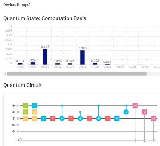

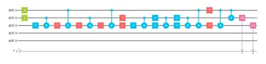

For many systems, implementing a Toffoli gate is far from as simple as implementing a single qubit (or even two qubit) gate. This answer gives a way of decomposing Toffoli into multiple smaller gates. However, in real systems, such as IBMQX, there can also be issues on which qubits can be used as targets. As such, a real life implementation on IBMQX2 looks like this: Single qubit half-adder on IBMQX2
Figure 3: Implementation of a half-adder on IBMQX2. In addition to decomposing the Toffoli gate into multiple smaller gates, additional gates are required as not all qubit registers can be used as targets. Registers q[0] and q[1] are added to get the sum in q[1] and the carry in q[2]. In this case, the result q[2]q[1] should be 10. Running this on the processor gave the correct result with a probability of 42.8% (although it was still the most likely outcome).

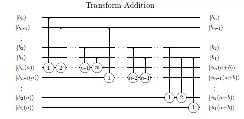

A new method for computing sums on a quantum computer is introduced. This technique uses the quantum Fourier transform and reduces the number of qubits necessary for addition by removing the need for temporary carry bits.
PDF link for 'addition on a quantum computer', written by Thomas G. Draper, written September 1, 1998, revised: June 15, 2000.
To summarize the above link, addition is performed according to the following circuit diagram (taken from page 6):
To quote the paper (again, page 6):
The quantum addition is performed using a sequence of conditional rotations which are mutually commutative. The structure is very similar to the quantum Fourier transform, but the rotations are conditioned on $n$ external bits.

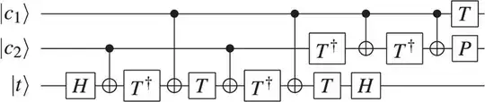

You can also decompose the Toffoli gate as a sequence of single-qubit and CNOT gates. https://media.nature.com/lw926/nature-assets/srep/2016/160802/srep30600/images/srep30600-f5.jpgenter image description here You can read about how to implement these with photonics, cavity-QED and trapped ions in Nielsen and Chuang.

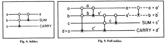

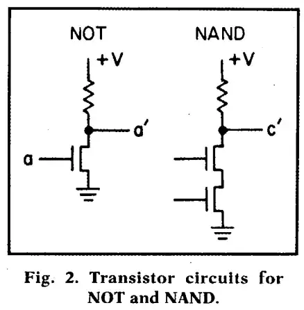

A quantum adder was "programmed" and compared with a transistor-based implementation in Feynman's 1985 "Quantum Mechanical Computers" - one of the earliest papers on quantum computing!
In that paper, Feynman initially reviews the classical implementation of a NOT gate and a NAND gate using resistor-transistor logic:
Feynman Resistor-Transistor Logic
Feynman notes issues with heat dissipation with such circuits (this was a much bigger concern in the mid-80's than it is now).
So Feynman goes on to discuss a reversible circuit to implement a half- and full-adder:
Feynman Half-and-Full Adder
(Note that he uses open bubbles $\circ$ rather than now-standard closed bubbles $\bullet$, and uses X's where most would use a circled-plus $\oplus$.)
Feynman builds a Hamiltonian using a "cursor" to control execution of his program with what we now call the circuit-to-Hamiltonian reduction, whereas now, we'd implement the gates with well-timed electromagnetic pulses (lasers or microwaves, for example).
But many of the ideas that are common and well-known in the field are already present and introduced in this (ancient) paper of Feynman.

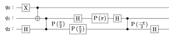

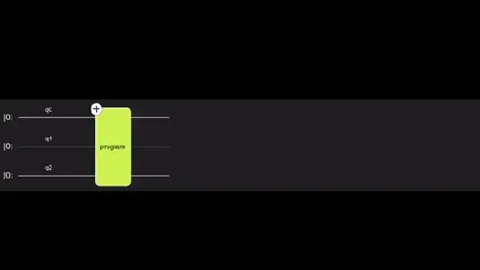

Parallel computation of the sum of two qubits
I wanted to experience parallel computation of the sum of two qubits, a superposition of 0 and "1 with phase -1" added to 1; and I was inspired by Mithrandir24601's answer. The results are below. I hope my answer is within the context of what was asked. It shows how 1 is added 1, and to 0, at the same time, but whilst both answers are calculated, we can read out the answer to only one of the calculations each time the computation is run. You can see that out of 1000 runs, 417 times we read out the answer "1" (1=0+1), and 380 times and we read out the answer "2" (2=1+1).
(34 times we got nought when the 1 bit was flipped to nought, 54 times we got 0=0+1, 29 times we got 1=1+1, 28 times we got 2=0+1, 42 times we got 3=0+1, and 16 times we got 3=1+1; each of these errors arising no doubt from bit flips, phase flips, or both). enter image description here
I thought an initial $\pi$ phase (created in the 1st of 3 Hadamard gates) represented a negative digit, but it just represents a positive digit with a -1 phase factor.
A superposition of 0 and "1 with phase -1" in a one qubit register is added to 1 in a two-qubit register. With three qubits, the first two qubits left to right is the sum (or the 3rd and 4th of 5) and the right-most qubit shows whether the ground state (treated as 0) was added or the excited state (1 with an initial phase of -1) was added.
