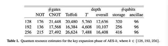

The authors construct quantum gate implementations of AES-128, AES-192 and AES-256. They Do it with Clifford+T gates "as the underlying fault-tolerant logical quantum gate set." Table 1 has their gate estimates and qubit estimates for the key expansion.

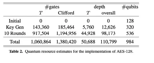

Table 2 has the quantum resource estimates for the AES-128 implementation:

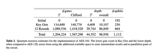

Table 3 has the resources for AES-192:

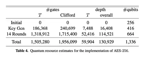

And Table 4 has the resource estimates for AES-256:

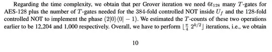

The part of the paper that I do not understand is the time estimates, and this probably goes back to some confusion that I have regarding Grover's algorithm. The challenge in cracking AES with Grover is not the complexity of the circuit (which results primarily from unwinding the multiple rounds), but from the number of "Grover iterations" that are required.
The key paragraph is at the bottom of p. 10 and the top of p. 11:
