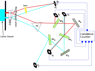

I will try to translate the Kim et. al. experiment from an optics description into a quantum information description. Here is the experimental setup as you find it in the linked wikipedia article:
the experiment

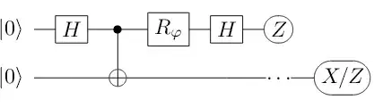

We associate the blue path with $|0\rangle$ and the red with $|1\rangle$. The double slit can be described by a Hadamard gate. The BBO corresponds to a CNOT-gate. The state after the BBO is $\frac{1}{\sqrt{2}}(|00\rangle + |11\rangle)$. There is a phase $\varphi$ depending on the position $x$ of detector $D_0$, which corresponds to a phase gate $R_\varphi=\operatorname{diag}(1,e^{i\varphi})$. Finally superposing the beams on $D_0$ corresponds to another Hadamard gate and the measurement of $D_0$ can be seen to project onto $|0\rangle$. The complete circuit looks like this:
The quantum circuit
The state before the measurement is: $$\frac{1}{2}(|00\rangle+|10\rangle + e^{i\varphi}|01\rangle - e^{i\varphi}|11\rangle)=\frac{1}{2}(((1+e^{i\varphi})|0\rangle+(1-e^{i\varphi})|1\rangle)|+\rangle + ((1-e^{i\varphi})|0\rangle +(1+e^{i\varphi})|1\rangle)|-\rangle)$$
Let's look at the probability to measure the first photon in $D_0$ ($|0\rangle\langle 0|$).
If we measure the second in z-basis ($D_3$ and $D_4$), the probability for a click in $D_0$ is $\frac{1}{2}$ (the post-measurement state is $|\pm\rangle$). This is independent of the phase: no interference here. For the x-basis ($D_1$ and $D_2$) the probability for a click at $D_0$ is $\frac{1}{2}(1\mp \cos \varphi)$, so here we see the interference. Whether we see interference or not depends on the basis choice on the second system, which can be delayed. Of course we need to know the outcome, so faster than light communication is not possible with this setup.

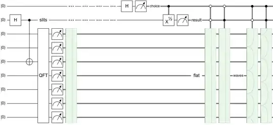

Quirk includes a mockup of the delayed choice eraser as an example circuit:
example circuit

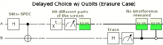

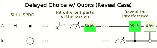

Any situation where you create an entangled state, and then switch between measuring in the same basis on both sides or a different basis will show the effect. You can reduce it down to fewer qubits if you're willing to give up the more visually direct waves in the output expectation:
reveal erase

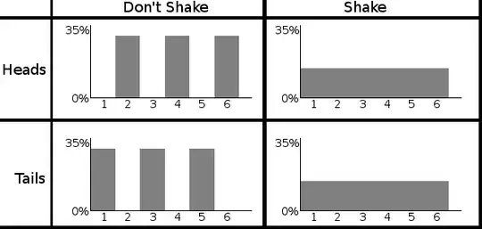

In fact you can even make classical analogues:
Bob has a six-sided die, a two-sided coin, and a small empty box to put the coin in. He rolls the die, gets a result between 1 and 6, and places the coin in the box in a way that depends on the die roll. If the die roll was even, the coin is placed heads up. If the die roll was odd, the coin is placed tails up. Bob then writes down his die roll, and carefully hands the box to Alice.
Alice now has to decide to either a) just open the box or b) shake the box before opening it. (Shaking the box randomizes the coin.) Once the box is open, she writes down whether the coin was face up or face down, and also writes down whether or not she shook the box.
