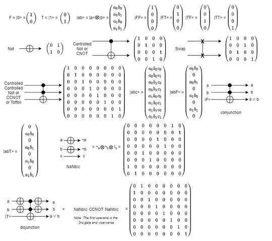

It seems to me that the "disjunction gate" (aside: is that its proper name?) can be thought of as the combination of three gates, G1, G2, and G3, where G2 is the CCNOT gate, and $G1 = G3 = ¬_a \otimes ¬_b \otimes I_c$. For context, see the bottom two rows of the following figure that I created in draw.io: Quantum computing summary
Is there a name for the gate $¬_a \otimes ¬_b \otimes I_c$ (the one I'm calling NaNbIc)?

would more often be called $X_1X_2I_3$ rather than $¬_a ¬_b I_c$, because we use $X$ to denote the NOT gate more often than we use $¬$.
However it is very unlikely that $X_1X_2I_3$ is given a new name, because there's nothing going on other than just two $X$ gates. CNOT has a name because the "C" part in CNOT denotes something that isn't quite so easily captured by something like $X,Y$ or $Z$. It seems that you have some familiarity with classical gates, is there any name for the 3-bit gate that does NOT to the first two bits and nothing to the third?

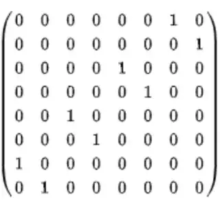

Looking more at your specific gate, each input is a single-qubit gate, and there's no way for any entanglement to be created with such a gate. For example, if each of $\vert a\rangle$, $\vert b\rangle$, and $\vert c\rangle$ were unentangled prior to the operation of the $\mathsf{HOCKING}$ gate, they would be afterwards.
Thus don't be surprised if your gate doesn't have a specific, universally recognized name.
