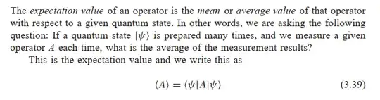

I was reading a book and then I found this statement. I will put the text as well as a screenshot of the text.
The expectation value of an operator is the mean or average value of that operator with respect to a given quantum state. In other words, we are asking the following question: If a quantum state $|\psi\rangle$ is prepared many times, and we measure a given operator $A$ each time, what is the average of the measurement results? This is the expectation value and we write this as $\langle A\rangle =\langle ψ|A|ψ \rangle$ (3.39)
Here is the screenshot,
