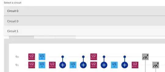

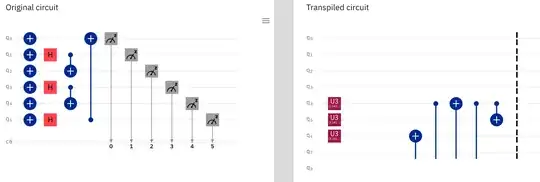

I have two (unrelated) questions when I run circuits on IBM Q Expierence.
The first one is encountered, when I run the built-in function VQE (for H2 molecule). It seems two circuits were run, and the resultant histograms seem to be different. See the first screenshot attached. I try to look up on the doc, but have no clue. May I know why is that?
The second one is encountered, when I try to create a circuit where the 0th qubit is controlled by the 5th one. This is run on ibm_16_melbourne. The compiled circuit is pretty strange, see the second screenshot attached, where the number of qubits does not seem to match (q0-q3, q8-q14 are not involved), and I am not sure if the desired property (described above) is respected. Any help would be greatly appreciated!
In both cases, the results seem to be correct/acceptable, so I think it is just a question of visualization on the IBM Q Expierence.

Answer to question 1: There are two circuits being executed because you are trying to find the expectation value of the Hamiltonian, $\langle \psi |H|\psi\rangle$ = $\langle \psi | \sum_i \alpha_i P_i | \psi \rangle = \sum_i \alpha_i \langle \psi|P_i|\psi\rangle $. So naively each circuit is representing one of the calculation of $\langle \psi|P_i|\psi\rangle $. For example, the electronic Hamiltonian for $H_2$ at bond distance 1.5 Angstrom under Parity Mapping with two-qubit reduction can be written as:
$$H = -1.009II + 0.1291IZ + -0.1291ZI -0.0041ZZ + 0.2295XX $$
but since $II, IZ, ZI, ZZ$ are in the same tensor product basis, they can be evaluated as single quantum circuit, and you just need to do some post processing calculations... that is you don't have to run 4 different quantum circuits, one for each. But $\langle XX \rangle$ need to have its own circuit. Hence the reason why you see two circuits here.

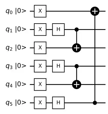

Regarding to question 2: I don't see how you do the transpilation process so I can't say much. When I see your orginial circuit:

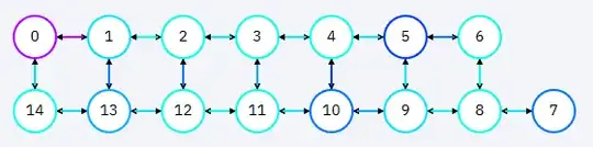

and look at ibmq_16_device which has qubit layout as enter image description here

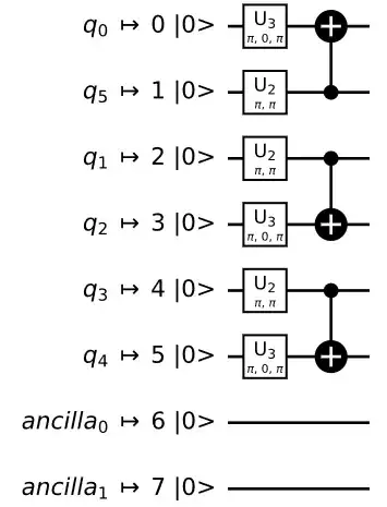

I would map $q_0 \to 1, q_5 \to 2, q_1 \to 3, q_2 \to 4, q_3 \to 5, q_4 \to 6 $ then this way your circuit can be executed in just depth of 2. There are other mapping you could do, of course. When I run the original circuit with optimization_level = 3 in Qiskit, I have the following transpiled circuit:

var_form = QuantumCircuit(6) params = ParameterVector('a', 6) for i in range(6): var_form.ry(params[i],i) var_form.cx(1,2) var_form.cx(3,4) var_form.cx(0,5)
This will give you the following parametrized circuit:
You can now pass this into your VQE function! Hope this helps. :)
