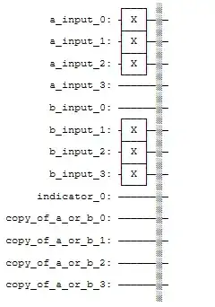

Give the following input: $$ A: 1110 \\ B: 0111 \\ \text{indicator}: 0 \text{ or } 1 $$ How do I copy the value of A or B to target qubits if indicator is 0 or 1 respectively?
In the image below, the indicator=0 so the value of the copy_of_a_or_b qubits should resemble a_input qubits:

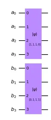

Let's set your current circuit:
from qiskit import *
a_input = QuantumRegister(4, name='a') b_input = QuantumRegister(4, name='b')
inputs = QuantumCircuit(a_input, b_input)
inputs.initialize('1110', a_input) inputs.initialize('0111', b_input)
inputs.draw('mpl')
(side note, if your run inputs.decompose().draw('mpl') you will notice that the order of the $X$ gates are going to be "in reverse". That's because Qiskit endianness.)

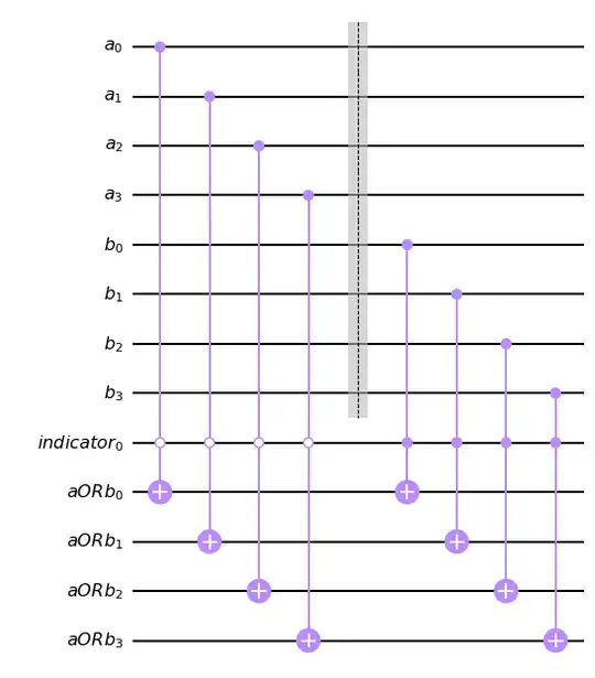

Now, time to create the multiplexer. This scales up the Cryoris' answer:
from qiskit.circuit.library import CXGate
indicator = QuantumRegister(1, name='indicator') a_or_b = QuantumRegister(4, name='aORb')
multiplexer = QuantumCircuit(a_input, b_input, indicator, a_or_b) for i in range(4): # If indicator is 0, copy from A multiplexer.append(CXGate().control(1, ctrl_state='0'), [indicator, a_input[i], a_or_b[i]])
multiplexer.barrier(a_input, b_input)
for i in range(4): # If indicator is 1, copy from B multiplexer.append(CXGate().control(1, ctrl_state='1'), [indicator, b_input[i], a_or_b[i]])
multiplexer.draw('mpl')

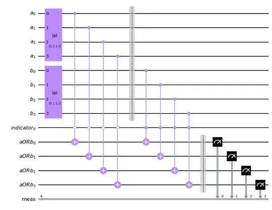

The composed result:
circuit = inputs + multiplexer + measure
circuit.draw('mpl')
Finally, we need to "set" the indicator qubit. Once circuit for each possibility:
indicator0 = QuantumCircuit(indicator)
indicator0.initialize('0', indicator)
indicator1 = QuantumCircuit(indicator) indicator1.initialize('1', indicator)
Time to test how it works:
job = execute(indicator0 + circuit, backend=BasicAer.get_backend('qasm_simulator'))
job.result().get_counts().keys()
dict_keys(['1110'])
job = execute(indicator1 + circuit, backend=BasicAer.get_backend('qasm_simulator'))
dict_keys(['0111'])
