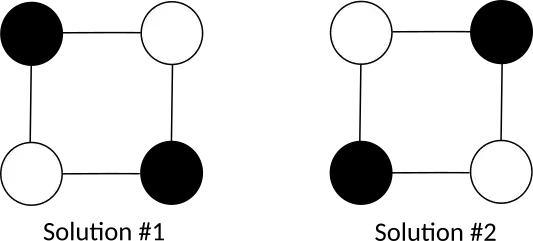

The 'Hello World' equivalent in the D-Wave world is the 2D checkerboard example. In this example, you are given the following square graph with 4 nodes:
                                                  square_graph
Let's define that we colour vertex $\sigma_{i}$ black if $\sigma_{i} = -1$ and white if $\sigma_{i} = +1$. The goal is to create a checkerboard pattern with the four vertices in the graph. There is various ways of defining $h$ and $J$ to achieve this result. First of all, there are two possible solutions to this problem:
               checkerboard_solutions
The D-Wave quantum annealer minimizes the Ising Hamiltonian that we define and it is important to understand the effect of the different coupler settings. Consider for example the $J_{0,1}$ coupler:
If we set it to $J_{0,1}=-1$, the Hamiltonian is minimized if both qubits take the same value. We say negative couplers correlate. Whereas if we set it to $J_{0,1}=+1$, the Hamiltonian is minimized if the two qubits take opposite values. Thus, positive couplers anti-correlate.
In the checkerboard example, we want to anti-correlate each pair of neighbouring qubits which gives rise to the following Hamiltonian:
$$H = \sigma_{0}\sigma_{1} + \sigma_{0}\sigma_{2} + \sigma_{1}\sigma_{3} + \sigma_{2}\sigma_{3}$$
For the sake of demonstration, we also add a bias term on the $0$-th qubit such that we only get solution #1. This solution requires $\sigma_{0}=-1$ and we therefore set its bias $h_{0}=1$. The final Hamiltonian is now:
$$H = \sigma_{0} + \sigma_{0}\sigma_{1} + \sigma_{0}\sigma_{2} + \sigma_{1}\sigma_{3} + \sigma_{2}\sigma_{3}$$

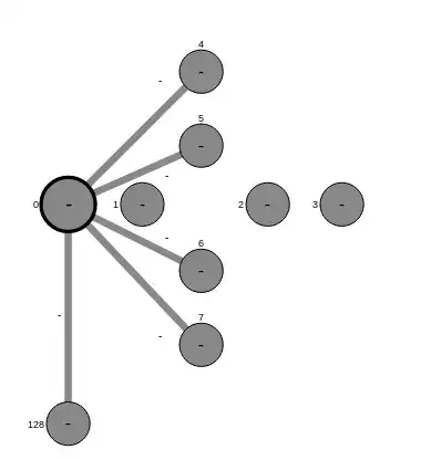

The unit cell in the top left corner on the D-Wave 2000Q chip layout above looks like this:
physical_qubits
Note, that not all couplers are visualized in this image. As you can see, there is no coupler between qubit $0$ and qubit $1$ which we would need to directly implement our square graph above. That's why we are now redefining $0\rightarrow0$, $1\rightarrow4$, $2\rightarrow7$ and $3\rightarrow3$. We then go on and define $h$ as a list and $J$ as a dictionary:
J = {(0,4): 1, (4,3): 1, (3,7): 1, (7,0): 1}
h = [-1,0,0,0,0,0,0,0,0]
