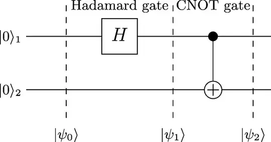

Assuming you are considering a gate-based quantum computer, the most easy way to produce an entagled state is to produce one of the Bell states. The following circuit shows the Bell state $\left| \Phi^+ \right>$.
Bellstate
By examining $\left| \psi_0 \right>$, $\left| \psi_1 \right>$ and $\left| \psi_2 \right>$ we can determine the entagled state after application of all gates:
1. $\left| \psi_0 \right>$:
Not much happens here since no gates were applied at this point. The state of the whole system is therefore just the tensorproduct of the single states which we write like this: $$ \left| \psi_0 \right> = \left | 0 0 \right > $$
2. $\left| \psi_1 \right>$:
The Hadamard-Gate applies on the first qubit which results in the following:
$$ \left| \psi_1 \right> =(H \otimes I)\left | 0 0 \right > = H\left | 0 \right > \otimes \left | 0 \right > = \frac{1}{\sqrt 2} \left (\left | 0 \right > + \left | 1 \right > \right ) \left | 0 \right > = \frac{1}{\sqrt 2} \left (\left | 0 0 \right > + \left | 1 0 \right > \right ) $$
3. $\left| \psi_2 \right>$:
Now a CNOT gate is applied and flips the second qubit but only where the first one has the value 1. The result is
$$ \left| \psi_2 \right> = \frac{1}{\sqrt 2} \left (\left | 0 0 \right > + \left | 1 1 \right > \right ) $$
This last state $\left| \psi_2 \right>$ is an entagled state and usually the most natural way to come up with such a situation. Bell states occure in a lot of interesting quantum algorithms such as super dense coding or teleportation.
