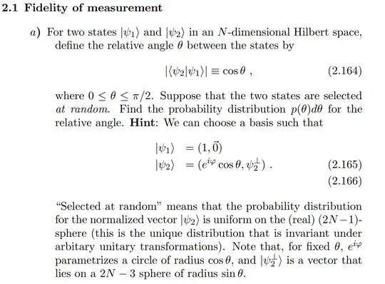

For some context, I am trying to assess the capacity that certain two qubit gates have to create entanglement. To do this I am using the idea of "entangling power", where one takes their favorite entanglement measure and takes some distribution over all the possible input states averaging over them to find the resulting concurrence.
I want to take a uniform distribution over all my possible inputs which would mean taking a uniform distribution over the tensor product of two Bloch Spheres.
I'm struggling to understand how to do this.
I feel the approach should be somewhat similar to what one would need to do to solve this Exercise from Preskill's notes Preskill Exercise but the jump of sampling from one to two Bloch Spheres does not seem obvious or simple to me.
In this paper, a sample over one Bloch Sphere is taken also.
Any ideas of how I should approach this?
