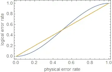

Error correction works for large error rates (smaller than $1/2$). Take for example the simple 3 qubit repetition code. The logical error rate is just the probability for the majority vote to be wrong (the orange line is $f(p)=p$ for comparison):
plot physical vs logical error rate
So whenever the physical error rate $p$ is below $1/2$, the logical error rate is smaller than $p$. Note however, that is particularly effective for small $p$, because the code changes the rate from $\mathcal{O}(p)$ to a $\mathcal{O}(p^2)$ behaviour.
