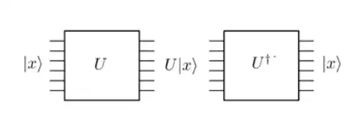

Evolution in quantum mechanics is unitary. And because it is unitary, it is reversible. This essentially means that if you apply a quantum gate $U$ on an input state $|x\rangle$ and get an ouput state $U|x\rangle$, you can always apply an inverse gate $U^{\dagger}$ to get back to the state $|x\rangle$.
Notice, carefully in the above picture that the number of input lines (i.e. six) is exactly same as the number of output lines at each step. This is because of the unitarity of the operations. Compare this to classical operations like the logical AND where $0\wedge1$ gives a single bit output $0$. You can't reconstruct the initial bits $0$ and $1$ from the output, since even $0\wedge 0$ and $1\wedge0$ would have mapped to the same output $0$. But, consider the classical NOT gate. If the input is $0$ it ouputs $1$, while if the input is $1$ it outputs $0$. Since this mapping is one-one, it can be easily implemented as a reversible unitary gate, namely, the Pauli-X gate. However, for implementing a classical AND or a classical OR gate we need to think a bit more.

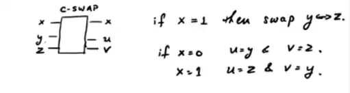

Consider the CSWAP gate. Here's a rough diagram showing the scheme:
In the SWAP gate depending on the control bit, we the other two may or may not get swapped. Notice that there are three input lines and three output lines. So, it can be modeled as a unitary quantum gate. Now, if $z=0$: If $x=0$, output is $0$, while if $x=1$, output is $y$.
If you notice, if $x=0$, we are outputting $\bar{x}\wedge y$ while if $x=1$ we are outputting $x\wedge y$. So we could successfully generate the output $x\wedge y$ which we wanted although we ended up with some "junk" outputs $\bar{x}\wedge y$ and $x$. An interesting fact is that the inverse of the CSWAP gate is the CSWAP gate itself (check!).
