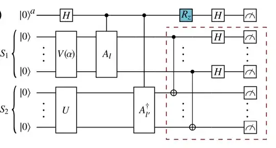

I am trying to understand a test called Hadamard Overlap Test, which consists of a destructive swap test (section IV of swap test and Hong-Ou-Mandel effect are equivalent) right after a Hadamard test. The circuit is from the Variational Quantum Linear Solver paper:
Hadamard overlap test
The authors claim that "conditioning the measurement on the ancilla qubit to yield the $|\boldsymbol{0}\rangle$ state, we can perform the depth-two Overlap circuit between registers S1 and S2 to get": \begin{equation} \begin{aligned} P(0) &=\frac{1}{2}\left(\left\langle\mathbf{0}\left|U^{\dagger} V\right| \mathbf{0}\right\rangle\left\langle\mathbf{0}\left|V^{\dagger} U\right| \mathbf{0}\right\rangle\right.+\left\langle\mathbf{0}\left|U^{\dagger} A_{l^{\prime}} A_{l} V\right| \mathbf{0}\right\rangle\left\langle\mathbf{0}\left|V^{\dagger} A_{l}^{\dagger} A_{l^{\prime}}^{\dagger} U\right| \mathbf{0}\right\rangle \\ &\left.+\operatorname{Re}\left[\left\langle\mathbf{0}\left|U^{\dagger} A_{l} V\right| \mathbf{0}\right\rangle\left\langle\mathbf{0}\left|V^{\dagger} A_{l^{\prime}}^{\dagger} U\right| \mathbf{0}\right\rangle\right]\right) \end{aligned} \end{equation}
$|\boldsymbol{0}\rangle$ represents a vector of 0 qubits, those making up the registers $S_1$ or $S_2$. I can't understand how to derive this result. In particular, I have the following questions:
  • What are we exactly measuring by $P(0)$? From the circuit, it seems like all the qubits are measured, and that is also the case when you do a swap test according to the reference above. I initially thought that $P(0)$ is the probability of getting 0 in the ancilla, but this should not be the case, because otherwise what is the effect of the CNOT and H performed? What I mean is that the gates inside the box are not controlled on the ancilla, so they cannot change the outcome of the ancilla.
  • How do you get to this result? Below is my attempt and what I achieved so far
\begin{equation} \begin{aligned} & |0 \rangle |\boldsymbol{0} \rangle |\boldsymbol{0} \rangle \xrightarrow{V, U} |0 \rangle V|\boldsymbol{0} \rangle U|\boldsymbol{0} \rangle \xrightarrow{H}\frac{1}{\sqrt{2}}\left(|0 \rangle +|1 \rangle \right)V|\boldsymbol{0} \rangle U|\boldsymbol{0} \rangle \xrightarrow{A_l, A_{l'}^{\dagger}}\\ &\frac{1}{\sqrt{2}}\left(|0 \rangle V|\boldsymbol{0} \rangle U|\boldsymbol{0} \rangle +|1 \rangle A_lV|\boldsymbol{0} \rangle A_{l'}^{\dagger}U|\boldsymbol{0} \rangle \right) \xrightarrow{H}\\ & \frac{1}{2}\left[|0 \rangle(V|\boldsymbol{0} \rangle U|\boldsymbol{0} \rangle +A_lV|\boldsymbol{0} \rangle A_{l'}^{\dagger}U|\boldsymbol{0} \rangle )+|1 \rangle (V|\boldsymbol{0} \rangle U|\boldsymbol{0} \rangle -A_lV|\boldsymbol{0} \rangle A_{l'}^{\dagger}U|\boldsymbol{0} \rangle )\right] \end{aligned} \end{equation} Now, one measures the ancilla, if it results in a 0 state, the system collapses in \begin{equation} \frac{1}{2}(V|\boldsymbol{0} \rangle U|\boldsymbol{0} \rangle +A_lV|\boldsymbol{0} \rangle A_{l'}^{\dagger}U|\boldsymbol{0} \rangle) \end{equation} How does one implement the the CNOTs and H now? What are the further steps that yields the results of the authors?

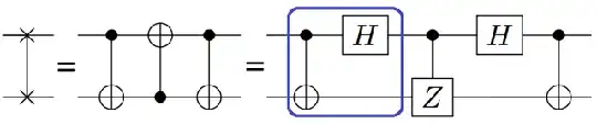

The key idea behind the Destructive Swap Test corresponds to the following circuit identity:

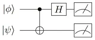

In words, the SWAP gate is equal to the diagonal matrix CZ up to a similarity transformation $\textrm{SWAP} = U^{\dagger} \; CZ \; U$, where $U$ corresponds to the subcircuit shown inside the blue box. Hence, we can compute the expectation value of SWAP by executing the following circuit
and associating $+1$ with all trials that yield $00$, $01$ and $10$, and $-1$ with all trials that yield $11$, as in $\textrm{CZ} = \textrm{diag}(1,1,1,-1)$. More concretely, the computed expectation value is
$\textrm{Tr}(\textrm{CZ} \; U(|\phi \rangle \otimes |\psi \rangle) (\langle \phi | \otimes \langle \psi |) U^{\dagger}) = \textrm{Tr}([U^{\dagger} \; CZ \; U] (|\phi \rangle \otimes |\psi \rangle) (\langle \phi | \otimes \langle \psi |)) = \textrm{Tr}(\textrm{SWAP} (|\phi \rangle \otimes |\psi \rangle) (\langle \phi | \otimes \langle \psi |)) = |\langle \phi | \psi \rangle|^2$.
The generalization to an arbitrary number of qubits $n$ for each register encoding the $n$-qubit states $|\phi \rangle$ and $|\psi \rangle$ simply corresponds to repeating this two-qubit circuit for all pairs of qubits of equal significance from each state. This corresponds to the last step of the circuit shown in the question, associated with the circuit inside the dashed line box.
Thus far, we have only considered separable states of the form $|\phi \rangle \otimes |\psi \rangle$. However, we can also consider its extension to the case where there is entanglement between the two $n$-qubit registers, which is the relevant case to answer this question. Suppose we have the following input state, $|\phi_1 \rangle \otimes |\psi_1 \rangle + |\phi_2 \rangle \otimes |\psi_2 \rangle$. The expectation value of the SWAP operator is
$\langle \textrm{SWAP} \rangle = (\langle \phi_1 | \otimes \langle \psi_1 | + \langle \phi_2 | \otimes \langle \psi_2 |) \; (|\psi_1 \rangle \otimes |\phi_1 \rangle + |\psi_2 \rangle \otimes |\phi_2 \rangle) = \langle \phi_1 | \psi_1 \rangle \langle \psi_1 | \phi_1 \rangle + \langle \phi_2 | \psi_2 \rangle \langle \psi_2 | \phi_2 \rangle + \langle \phi_1 | \psi_2 \rangle \langle \psi_1 | \phi_2 \rangle + \langle \phi_2 | \psi_1 \rangle \langle \psi_2 | \phi_1 \rangle$
This is precisely the result that we need to arrive at $P(0)$ stated above (cf. Eq. (C3) in reference paper). As derived in the statement of the question, the wave function encoded in S1 + S2 before this Destructive Swap Test and after the ancillary qubit is measured in $|0\rangle$ is
$\frac{1}{2} (V |0 \rangle \otimes U |0 \rangle + A_l V |0 \rangle \otimes A_{l'}^{\dagger} U |0 \rangle)$.
Hence, setting $|\phi_1 \rangle = \frac{1}{\sqrt{2}} V |0 \rangle$, $|\psi_1 \rangle = \frac{1}{\sqrt{2}} U |0 \rangle$, $|\phi_2 \rangle = \frac{1}{\sqrt{2}} A_l V |0 \rangle$ and $|\psi_2 \rangle = \frac{1}{\sqrt{2}} A_{l'}^{\dagger} U |0 \rangle$ in the previous equation for the entangled case yields the desired expression for $P(0)$, apart from a minor typo: The third term should have coefficient 1 (i.e., it should be outside the curved brackets), since $\textrm{Re}(a) = \frac{1}{2}(a + a^{*})$.
