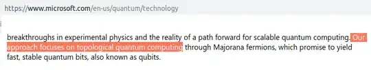

So you are at least aware that Microsoft is invested in topoligical quantum computing. You can even see it directly from microsoft.com:
So now the answer to your question:

We need to wait until anyons are confirmed to actually exist, before we can create a quantum computer out of them. While it is possible that Microsoft is working on some other type of quantum computing without telling us, all we know for sure is that their website says "Our approach focuses on topological quantum computing" which means that they do not have any physical device yet. They have made plenty of achievements in quantum computing theory though, as well as software such as liquid. No hardware though.
