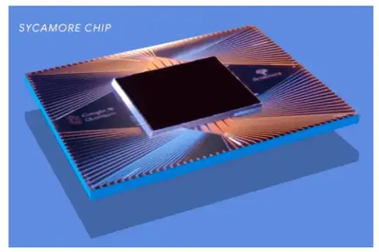

This can indeed be done right now. For example, why not put two of Google's Sycamore chips next to each other and connect the two with some wires:
This can be done, but I am not surprised that it hasn't been done yet, because even the first chip was only recently developed, and they were spending all their efforts on designing and optimizing the first chip, before even considering putting two of them together.
The next question is whether or not putting two chips together would even be the best thing to do right now. Putting two chips together seems like a smart thing to do once you've somewhat exhaustively optimized the performance/abilities of a single chip, and the only way to gain any further performance benefit would be to add a second chip and connect the two by some inter-chip connection which is by its very nature, not as efficient as intra-chip connections.

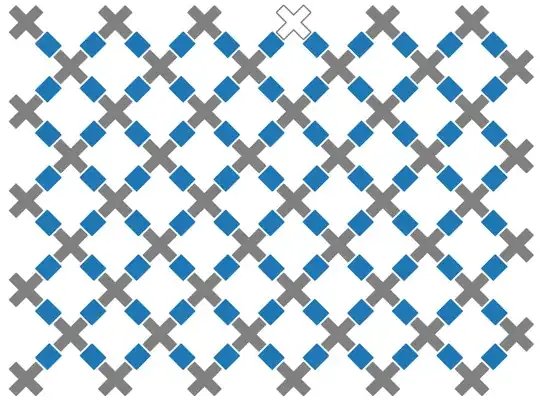

In the above chip, the grey qubits are connected by the blue connections in the picture below:
Should we continue to optimize the number of grey qubits and blue connections (i.e. the number of qubits in a single chip) or should we jump ahead and try to start connecting grey qubits from this chip to grey qubits on another chip?
What it boils down to is this: Do you want to rush and make a dual-processor with 50 qubits each by 2023 (total: 100), or do you want to first try to make a 100-qubit single chip by 2022, then connect two of them together by 2024 (total: 200)? The years I am giving here will certainly not be exact, but I am just trying to illustrate a point. Furthermore, most people in the field will say that neither of these choices are preferred, since what they really want is for the 50 qubits in a single chip (and the 2-qubit gates between them) to be more robust.
