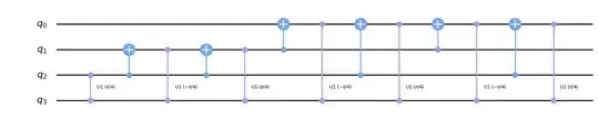

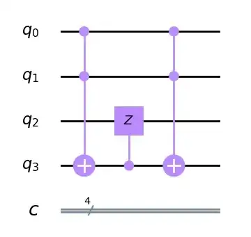

I am trying to make circuit for $C^3Z$ gate I have seen a circuit for $C^2Z$ or $CCZ$ gate made by using $CCX$ gate so is there any way to make circuit for $C^3Z$ in this similar manner( i.e by using $CCX$ gate) or i have to do something different then this method Fig. is below for $CCZ$ gate enter image description here

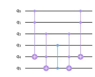

The circuit you showed above for the double-controlled $Z$ gate can be extended to a triple-controlled $Z$ by adding an extra Toffoli and ancilla:
